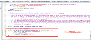

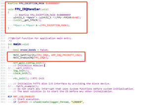

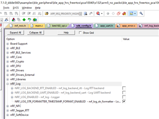

I am using nrf52832+freertos to develop a low-power product based on the example(ble_app_hrs_freertos) in the SDK, but now I find that the power consumption far exceeds expectations. In the case of unchanged examples, the power consumption exceeds 3.5mA. Even though I tried the following operations after referring to the questions in the forum, the power consumption still failed to decrease. Please help to solve it, thank you!

    Have you made sure configUSE_TICKLESS_IDLE is set to 1 ?
    The CPU is put to sleep inside vPortSuppressTicksAndSleep() via sd_app_evt_wait() call.

    I didn't change other code of ble_app_hrs_freertos,I'm sure the configUSE_TICKLESS_IDLE was set to 1,but current consumption still keep 3.5mA .
