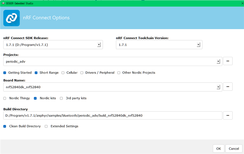

nRF Connect SDK can,t Add New File
nRF Connect SDK 1.7.1,  windows 10 X64

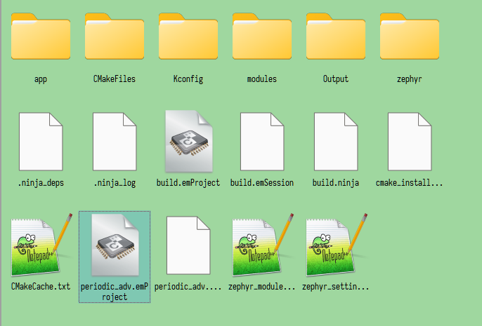

run SEGGER Embedded Studio.cmd  or click segger_embedded_studio IDE menu File->Open nRF Connect SDK Project,
it will be got tow project file (build.emProject  and  periodic_adv.emProject)

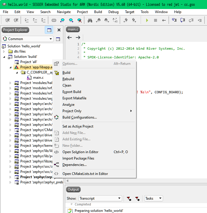

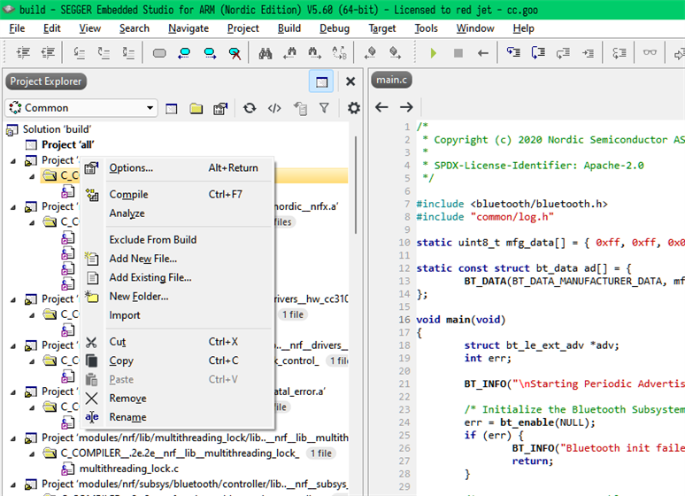

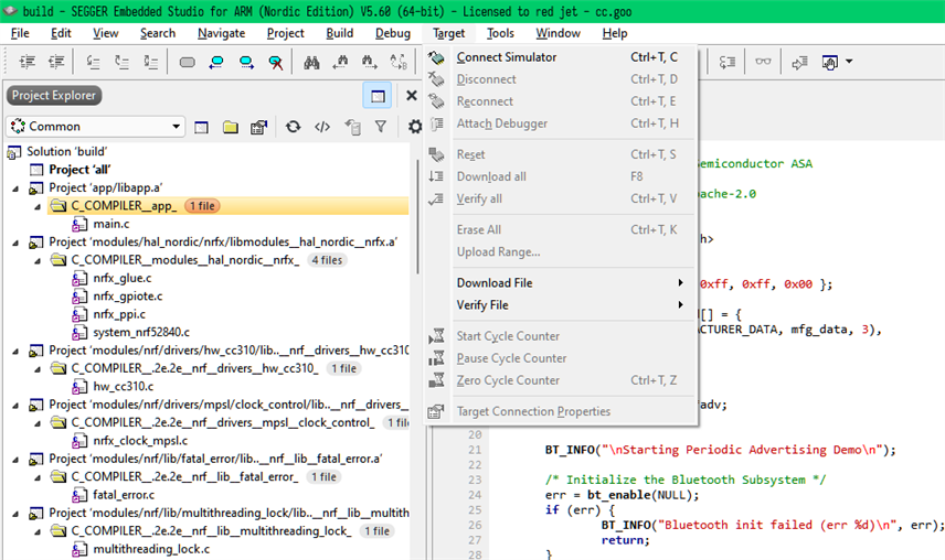

build.emProject                  can Add New File, but can't download;

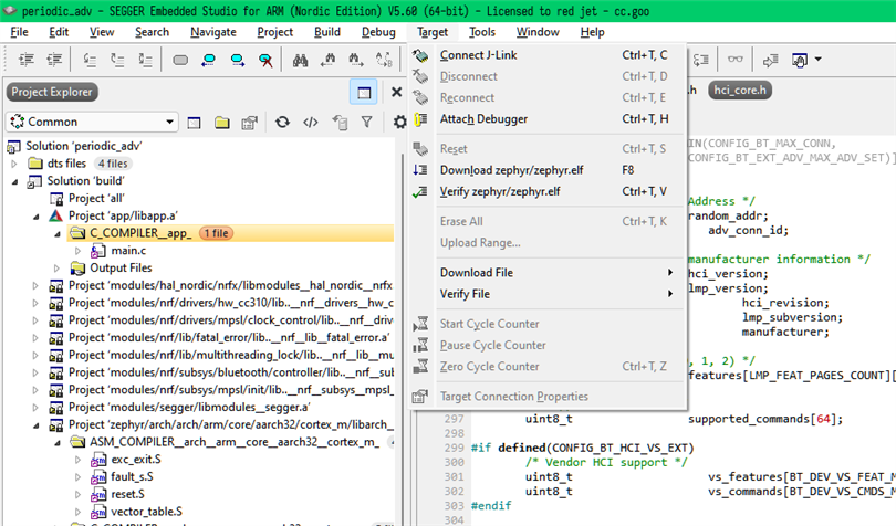

periodic_adv.emProject     can,t Add New File, but can download;
why had tow project file? and  menu[Add New File] and [Add Existing File] show Not available grey?

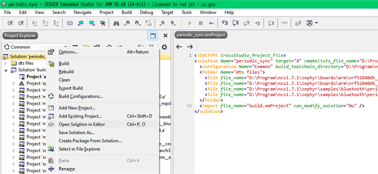

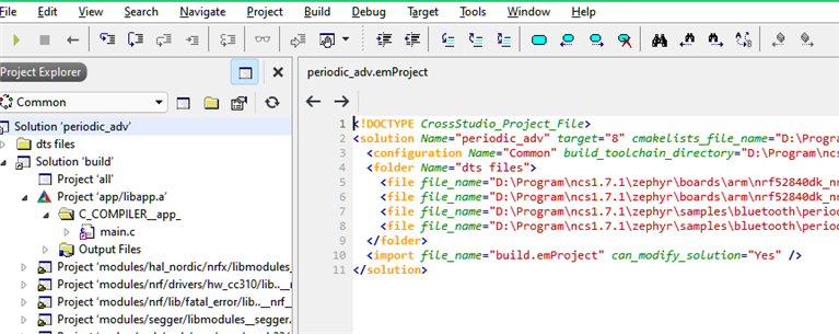

  • i had finded reason of why can'n "Add New File".
    right click bese Solution, cilck Open Solution in Editor.
    can_modify_solution="No"   change to   can_modify_solution="Yes",Save ReLoad Project..
    why had tow project file? periodic_adv.emProject is Solution,build.emProject  is projects.

    Regarding the 2 .emProject, the one you should use is the periodic_adv.emProject.

  • thanks a lot,
    can't find Add new file to CMakeLists.txt.
    but i had got it,
    it will be work well.
