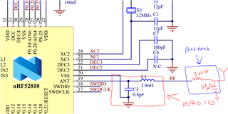

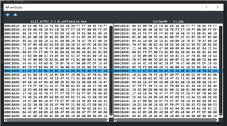

Hello all,
I have recently developed a custom board that uses an nrf52810. It also contains an accelerometer as well as some hardware for regulating the voltage and charging a battery. The issue I am having is that the device is unable to advertise. I have been searching around the internet for days however have been unable to find a solution to my problem. I am using sdk17.1.0 and softdevice s112 v7.2.0. I have been trying to use the ble_blinky_pca10040e example to help me start learning to develop for this board. My board does not contain a LF clock and therefore I set it to use the RC in the sdk_config. I have also set the ram and flash sizes appropriately. I have made numerous other modifications to the sdk_config however nothing appears to work. I at first used rtt viewer to see the logs from the device while it ran and it would sometimes throw errors while attempting to set BLE_CONN_CFG_GAP, BLE_GAP_CFG_ROLE_COUNT, etc, sometimes with a fatal error thrown as well. I started using SES to debug the application. When the program is loaded onto the device it runs until it hits ble_stack_init and then either halts on the register at 00000A60, or (more often) gets stuck on the line SVCALL(SD_SOFTDEVICE_ENABLE, uint32_t, sd_softdevice_enable(nrf_clock_lf_cfg_t const * p_clock_lf_cfg, nrf_fault_handler_t fault_handler));. The errors commented above the call make me think that it has something to do with the LF clock config however if I check the configuration it is correct. (set to RC, accuracy to 1, RC_CTIV 16, RC_TEMP_CTIV to 2), and I can also see the correct values in the variable when debugging. The device is able to run examples that do not involve BLE (like the blinky example) without issue. This is my first time taking on a project this large and I will admit at this point I am feeling rather lost. Any assistance is greatly appreciated. I am also happy to upload any code or hardware files should anyone require them.

  • Hey Jared,
    Sorry, I forget to mention that I reworked the designs slightly and connected dec4 correctly, before I did that the devices would not even power up. It was a mistake I made because easyeda had incorrect pin labels and I did not check (woops). The circuit on p0.25 and p0.28 was the dc/dc regulator set up that I fixed. In my next design I will make sure to correct the antenna issue, thanks for pointing that out. That said the chip still hangs on the SVC call for enabling the ble stack. Do you know if any examples exist that are programmed specifically for the nrf52810? I have a dev kit coming in soon as well and will be able to use that as a reference. Also the pcb is just 2 layers so there is a copper layer on the top layer that the ground nets to.
    Thanks again Jared!
