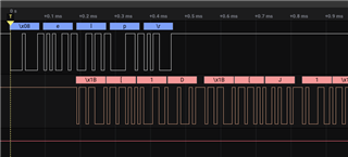

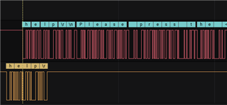

  • I checked with a logic analyzer, using an FTDI -> uart1 it works perfectly fine. The jlink ACM (uart0), however, fails to send the first character correctly. Seems the issue is with Jlink? I am sending the data using the exact same command to both interfaces python -c "import serial; s = serial.Serial('/dev/ttyACM0', baudrate=115200); s.write(b'help\r')"
    FTDI -> uart1
    Jlink ACM -> uart0

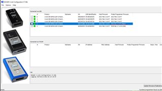

  • With the help of the Zephyr community I figured out that the issue is with the latest FW bundled with J-Link Software and Documentation Pack. This FW gets updated automatically (did not realize this) and that is why the issue persisted.
    The fix for me is to use the Jlink FW bundled with J-Link Software and Documentation 7.58d which include FW J-Link OB-SAM3U128-V2-NordicSemi compiled Feb  2 2021 16:47:20.
    J-link 7.58e & 7.60 contain FW J-Link OB-SAM3U128-V2-NordicSemi compiled DEC  3 2021 15:41:28 which was broken for me.

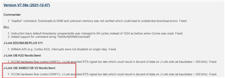

    I believe this FW is released by Segger, it is bundled with https://www.segger.com/downloads/jlink/. Looking at the release notes I think this is the offending change
    I've been keeping an eye out on the release notes but haven't seen any further updates to this particular firmware so I can only assume it has not been fixed.
