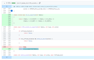

[00:00:00.201,782] <dbg> mcp2515_can.socket_can_init: Init socket CAN device 0x2 a680 (SOCKET_CAN_1) for dev 0x2a6b0 (CAN_1)
[00:00:00.217,376] <dbg> net_core.net_init: (main): Priority 90
[00:00:00.225,982] <dbg> net_core.l3_init: (main): Network L3 init done
[00:00:00.235,290] <dbg> mcp2515_can.socket_can_iface_init: Init CAN interface 0 x200149f8 dev 0x2a680
uart:~$ *** Booting Zephyr OS build v2.6.99-ncs1-1 ***
[00:00:00.252,014] <inf> net_socket_can_sample: sleeping for 2 seconds
[00:00:02.261,352] <err> net_socket_can_sample: Cannot create 1st CAN socket (-106)
[00:00:02.271,972] <err> net_socket_can_sample: Cannot start CAN application (-106)

  • Hi Tomas
    The CAN library doesn't work unless you have a board that supports it.
    The library uses the MCP2515 CAN driver, which is not available on the nRF9160DK.
    The Requirements section in the sample readme lists the supported boards.

  • Hi and thank you for the answer.
    I have added a MCP2515 can module to my board.
    My installed shield
    In the text bellow i belive the four first line  the candrive are started. (CAN_1)
    what could be the reason for the errors on the two last lines ?
  • Hi
    I discussed the case with Øivind, which helped you out in the other case, and he pointed out that by default the example might use a different socket implementation than the one the CAN sample expects. The nRF9160 device is normally used for IP communication over LTE, and if the nrf91_socket implementation is used then it makes sense that it would fail when trying to communicate over the CAN bus.
    In order to test this it should be possible to run the sample with logging enabled for the network drivers, by uncommenting the following lines from the prj.conf file:
    #CONFIG_NET_CONTEXT_LOG_LEVEL_DBG=y
    #CONFIG_NET_CORE_LOG_LEVEL_DBG=y
    #CONFIG_NET_CONN_LOG_LEVEL_DBG=y
    Could you try to make this change, run the sample, and let me know what log output you get?
    Best regards
    Torbjørn
  • Bellow you can see the two differnt settings for debug and the outputs i get.
    When copiling i get also a warning that i added in the bottom.
    (My final goal is to read data from CANBUS and send to AWS)

  • Hi Tomas
    I discussed this with one of the developers, and he found a potential issue with the nrf91_socket implementation that might explain the issue you are seeing.
    Essentially it will accept any query, regardless of AF type, even if it doesn't support all AF families (such as CAN):
    https://github.com/nrfconnect/sdk-nrf/blob/main/lib/nrf_modem_lib/nrf91_sockets.c#L1290
    He was able to patch this issue, and you can check out the patch in this pull request:
    https://github.com/nrfconnect/sdk-nrf/pull/6593
    Could you try to apply this patch on your end and see if it fixes the issue?
    Best regards
    Torbjørn

    after the requested modification i got this error on build.
