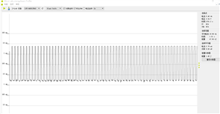

    Where master and slave is connecting, and then master is shutdown or move far away.Slave is wait for timeout.But the current of  average slave eelectric current
Higher and higher。The picture below we can see the radio rx window time is bigger and bigger。
  The conn_param :
    conn_intval 100ms
   slave_latency  9
   supervision  timeout  3000ms
The question is the radio rx window will Increase the current.
We want to confirm the  longer the current peak duration becomes  is reasonable?Why the radio rx window become bigger and bigger?
