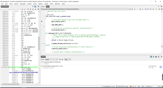

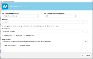

after deploied peripheral peoject into nRF52833 and enter debugging, the program was blocking in somewhere.
Could you try to enabling logging CONFIG_LOG=y in the prj.conf file, open a terminal and see if you get any useful information about why it's failing? If you're debugging you may want to set CONFIG_DEBUG_OPTIMIZATIONS=y.
By the way, if you're starting a new project in NCS, we recommend using nRF Connect for VS Code:

It was a wrong clock source choice cause this problem, after selected Synthesized from HFCLK <CLOCK_CONTROL_NRF_K32SRC_SYNTH>, the program can run as nomal.
Is any configure should i change to support 32MHZ external system clock? If not, i consider i had fixed this problem.
Thanks.
I'm happy you found a solution. I guess you're using a custom board without an external LF crystal.
You can also use the RC oscillator (CLOCK_CONTROL_NRF_K32SRC_RC), read more about the different options here: https://infocenter.nordicsemi.com/index.jsp?topic=%2Fps_nrf52833%2Fclock.html&cp=4_1_0_4_3_1&anchor=concept_xkj_np1_2r
