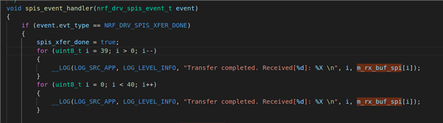

Hi Team,
When the slave side of the SPI received data from the master side, I want to log the received data to judge If it is right. But, I want to print it by log. it can only view 20 or so characters, Also including some garbled characters. Could you tell me why?
With kind regards,
Gaosheng
  • Hi
    Hmm, okay. Can you show me how your log output so I can get a better understanding of what's going on? Please also explain what you expect?
    Please also let me know what GPIOs you are using for SPI communication.
    Simon
