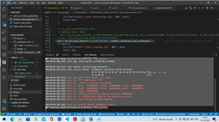

Hi Everyone,
I'm not able to start ble scan. I've followed following example...
Developing Bluetooth Low Energy products using nRF Connect SDK
 https://www.youtube.com/watch?v=hY_tDext6zA
I was able to advertise from my custom device. Now I want to add Bluetooth Central to this project.
I have added
CONFIG_BT_CENTRAL=y
 to the existing .conf file.
now coming to scan part...I have made this call in my bluetooth_init function, then I got the error as shown in screenshot. Is there any more setting I need to take care of?
and What is right way to start ble_scan?
  err = bt_le_scan_start(BT_LE_SCAN_ACTIVE,  remote_callbacks.scan_callback);
  • Hi
    I would suggest checking out I.E. the central_uart example and specifically the scan_init function we use. Then you can add a
    bt_scan_start() function afterwards to start scanning for bluetooth-devices.

  • Thanks for the help Simon.
    But i just had to add
    CONFIG_BT_GATT_CLIENT=y
    it works.
