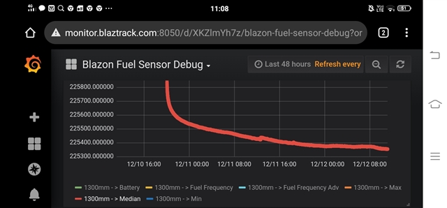

Frequency observed is showing a one sided trend, which continues for day. A fix source of frequency is connected to gpio, below shared graph shows frequency tick counted on nrf side via gpio.
Same source of frequency, which is in production already, normally shows a minor drift which goes up and down w.r.t. day night temperature in a periodic manner.

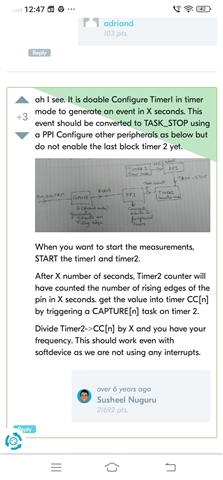

Whole of implementation is following below reference
https://devzone.nordicsemi.com/f/nordic-q-a/9036/measuring-input-gpio-pin-frequency-with-soft-device-running
Unable to debug this behaviour, no interrupts are used, all the modules are interconnected via PPI module. All sources of drift , crystal, frequency generator should act according to ambient temperature. Which should be roughly periodic. Supply voltage is also plotted and their is no such one sided trend in that.

    External frequency source is being measured in parallel via another frequency reader and am sharing a relative plot. Upper graph showing nrf reading, lower is showing a parallel reading with our existing in-production frequency reader.

  • Correct me if my understanding is incorrect.
    I should use a single timer in counter mode. Gpiote is linked to increment it.
    Start it -> wait for fixed time -> capture the value -> clear it
    Keep repeating.
    Do I need to pause resume all interrupts, maybe soft device, while running this one iteration.

    The problem here then is that the nRF is measuring the frequency of an external device, and you would expect that frequency to be stable. As there is a drift here, there is a relative change in frequency between the clock in the nRF and the clock in the device generating the signal. There is nothing in your measurements that indicate which of the devices has most of the clock drift though.
    If you have a proper high accuracy frequency counter instrument I suggest you use that to measure the frequency accuracy of both the nRF and the other device, which generates this signal. To measure it for the nRF you can use the GPIOTE Example (just modify it to use a higher frequency).
