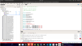

zephyr/zephyr_prebuilt.elf section `text' will not fit in region `FLASH'
I've been experimenting with nRF Connect SDK and compiling a program which supports provisioner mode, provisioning and direction finding.
Everything compiles and works fine, until I started adding direction finding code to it. The actual files seem to compile, but then I faced with an error:
My prf.conf has been changed accordingly to the sample. How to fix this?
