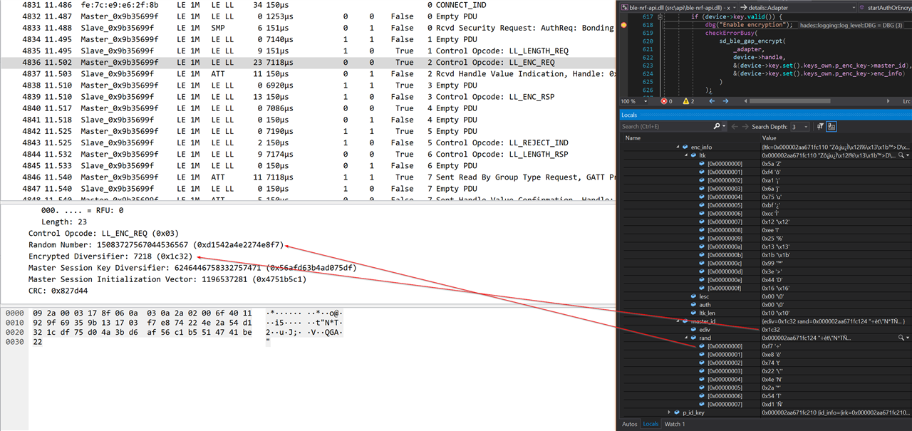

  • Thanks again Vidar. I'm now a little bit further. In case I found a stored key to the newly connected device, I call sd_ble_gap_encrypt() using the keyset: own/p_enc_key pair (received from BLE_GAP_EVT_AUTH_STATUS after bonding).
    But subscription to the DFU characteristic still fails in this case.
    Not sure if this is important. When receiving BLE_GAP_EVT_CONN_SEC_UPDATE I got two different security levels:
    Initial bond/sd_ble_gap_authenticate(): security_mode=1, level=2, key_size=16 -> DFU Char subscription success
    Reconnect/sd_ble_gap_encrypt(): security_mode=1, level=1, key_size=0 -> DFU Char subscription fails (BLE_GATT_STATUS_ATTERR_INSUF_AUTHENTICATION)
    Just in case this may be useful, here's the call to sd_ble_gap_encrypt() in the debugger. The key may be valid .. (it's a list not 0x00, 0x00, ..).

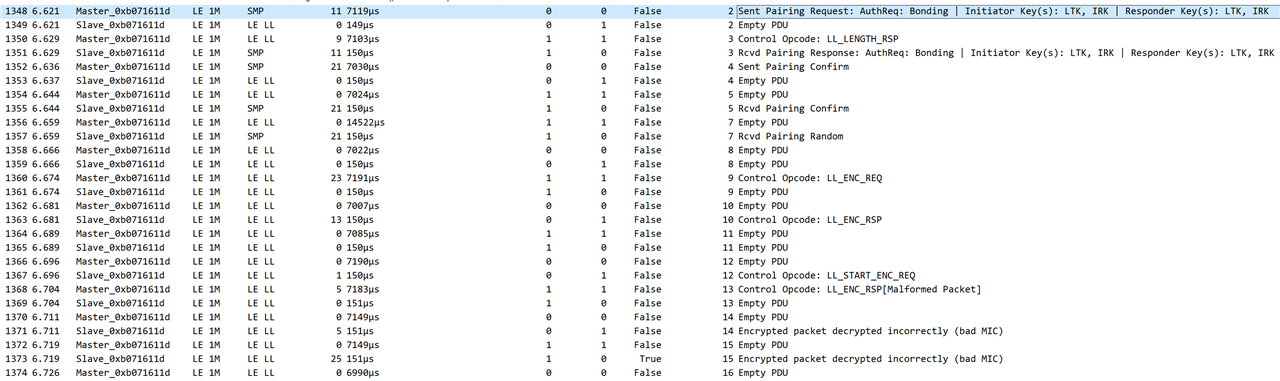

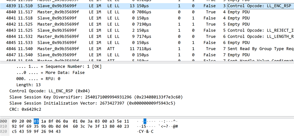

  • I've sniffed both the initial bond and the reconnect case. When doing the initial bond, data is encrypted when I start to discover services (after calling sd_ble_gap_authenticate()), while in the reconnect case, the discovery part is unencrypted (as you mention).
    The image below shows the section when I try to reconect. If I understand correctly, LL_ENC_REQ is triggered by the call to sd_ble_encrypt(). Comparing the information from VS debugger with the sniffed data, the master id is sent correctly (red arrows).
    Following the response from the peripheral (LL_ENC_RSP).
    For completeness, finally the log from the previous bonding:
    I'm not sure if this is helpful.
    Anyway, if the key that I use calling sd_ble_encrypt() would be corrupt, wouldn't this not totally fail? As said, I still got security_mode=1, level=1 from BLE_GAP_EVT_CONN_SEC_UPDATE. I expect this wouldn't be the case using a corrupted key.
