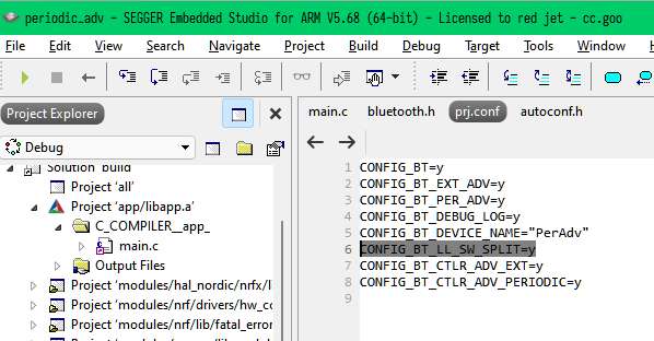

I have two nRF52840 DK with nRFConnect SDK 1.7.1
Compiled and run on nRF52840 boards:
   \ncs1.7.1\zephyr\samples\bluetooth\periodic_adv
   \ncs1.7.1\zephyr\samples\bluetooth\periodic_sync
i've only changed prink to BT_INFO.
I found that in the periodic_adv,
   mfg_data[2]++;
is sent with the advertisements, but it is not received at periodic_sync:
The debug run printout :

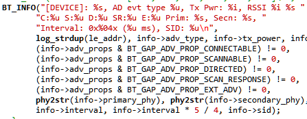

 [DEVICE]: 21:B6:31:15:B8:3C (random), AD evt type 5, Tx Pwr: 127, RSSI -53 PerAdv C:0 S:0 D:0 SR:0 E:1 Prim: LE 1M, Secn: LE 2M, Interval: 0x0000 (0 ms), SID: 0
In the periodic_sync, function void scan_recv ()
    if (!per_adv_found && info->interval) {
        per_adv_found = true;
        per_sid = info->sid;
        bt_addr_le_copy(&per_addr, info->addr);
        k_sem_give(&sem_per_adv);
info->interval always 0.
And  callbacks     sync_cb,    recv_cb  are never called.
Did I miss anything?
thank a lot.

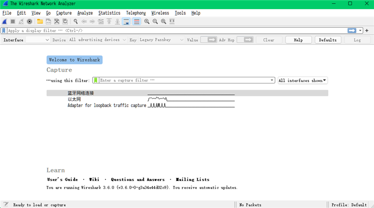

maybe I can't use Wireshark-win64
    When the Sniffer is not showing up as an interface in Wireshark it usually because the Python version invoked by Wireshark is missing the PySerial dependency. Maybe you have several versions of python installed?
    Either way, please check the log.txt file in %APPDATA%/Nordic Nordic Semiconductor/Sniffer/logs for errors. It may help us confirm what the problem is.
    Vidar
    Vidar
  • Hello,Vidar Berg,
    thanks for your reply,
    I can't find the logs anywhere.
    if add filter  [if(strcmp(name,"PerAdv")==0)],will get printout BT_INFO as follow,
    but  callbacks  sync_cb,recv_cb  are never called.

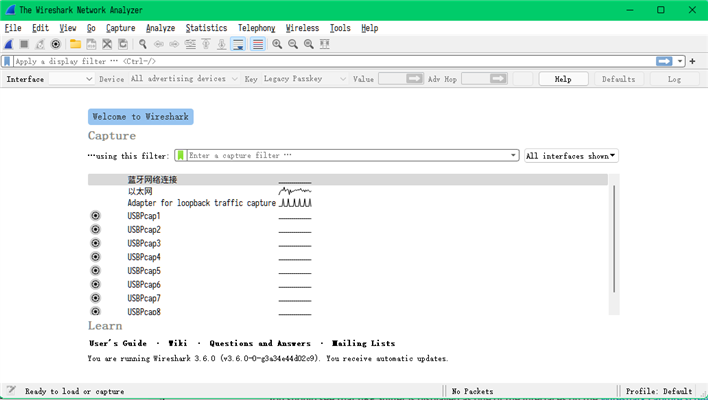

  • Hello,Vidar Berg,   i'm sorry.
    Please ignore my previous reply,I've found log.txt,  and capture the le data.
    thank a lot.

    16-Dec-2021 14:58:47 (+0800) INFO: Opening serial port COM10
    16-Dec-2021 14:58:47 (+0800) ERROR: Error opening UART could not open port 'COM10': PermissionError(13, '�ܾ����ʡ�', None, 5)
      File "D:\Program\Wireshark\extcap\SnifferAPI\Packet.py", line 74, in __init__
        self.uart = UART.Uart(portnum, baudrate)
      File "D:\Program\Wireshark\extcap\SnifferAPI\UART.py", line 124, in __init__
        self.ser = serial.Serial(
      File "C:\Python310\lib\site-packages\serial\serialwin32.py", line 33, in __init__
        super(Serial, self).__init__(*args, **kwargs)
      File "C:\Python310\lib\site-packages\serial\serialutil.py", line 244, in __init__
        self.open()
      File "C:\Python310\lib\site-packages\serial\serialwin32.py", line 64, in open
        raise SerialException("could not open port {!r}: {!r}".format(self.portstr, ctypes.WinError()))
    serial.serialutil.SerialException: could not open port 'COM10': PermissionError(13, '�ܾ����ʡ�', None, 5)
    16-Dec-2021 14:58:47 (+0800) INFO: Opening serial port None
        self.open()
    16-Dec-2021 14:58:47 (+0800) INFO: closing UART
    16-Dec-2021 14:58:48 (+0800) INFO: closing UART
    16-Dec-2021 14:58:48 (+0800) INFO: Opening serial port COM2
    16-Dec-2021 14:58:48 (+0800) INFO: Opening serial port COM18
    16-Dec-2021 14:58:49 (+0800) INFO: closing UART
    16-Dec-2021 14:58:49 (+0800) INFO: Opening serial port COM18
    16-Dec-2021 14:58:49 (+0800) INFO: Exiting PID 6732
    16-Dec-2021 14:58:50 (+0800) ERROR: Error opening UART could not open port 'COM10': PermissionError(13, '����ϵͳ�ϵ��豸û�з������á�', None, 31)
      File "C:\Users\Administrator\AppData\Roaming\Wireshark\extcap\SnifferAPI\Packet.py", line 74, in __init__
      File "C:\Users\Administrator\AppData\Roaming\Wireshark\extcap\SnifferAPI\UART.py", line 124, in __init__
        self.open()
    serial.serialutil.SerialException: could not open port 'COM10': PermissionError(13, '����ϵͳ�ϵ��豸û�з������á�', None, 31)
    16-Dec-2021 14:58:50 (+0800) INFO: Opening serial port None
    16-Dec-2021 14:58:50 (+0800) INFO: Opening serial port COM1
    16-Dec-2021 14:58:50 (+0800) INFO: closing UART
    16-Dec-2021 14:58:50 (+0800) INFO: Opening serial port COM2
    16-Dec-2021 14:58:51 (+0800) INFO: closing UART
    16-Dec-2021 14:58:51 (+0800) INFO: Opening serial port COM2
    16-Dec-2021 14:58:51 (+0800) INFO: Opening serial port COM18
    16-Dec-2021 14:58:52 (+0800) INFO: Opening serial port COM18
    16-Dec-2021 14:58:52 (+0800) INFO: closing UART
    16-Dec-2021 14:58:52 (+0800) INFO: Exiting PID 12788
    16-Dec-2021 14:58:54 (+0800) INFO: --------------------------------------------------------
    16-Dec-2021 14:58:54 (+0800) INFO: Software version: 4.1.0
    16-Dec-2021 14:58:54 (+0800) INFO: Started PID 2628
    16-Dec-2021 14:58:54 (+0800) INFO: Namespace(capture=False, extcap_interfaces=False, extcap_interface='COM20-3.6', extcap_dlts=False, extcap_config=True, extcap_capture_filter=None, fifo=None, extcap_control_in=None, extcap_control_out=None, extcap_version=None, device='', baudrate=None, only_advertising=False, only_legacy_advertising=False, scan_follow_rsp=False, scan_follow_aux=False, coded=False)
    16-Dec-2021 14:58:54 (+0800) INFO: main exit PID 2628
    16-Dec-2021 14:58:54 (+0800) INFO: Exiting PID 2628
    16-Dec-2021 14:58:54 (+0800) INFO: Started PID 11928
    16-Dec-2021 14:58:54 (+0800) INFO: main exit PID 11928
    16-Dec-2021 14:58:54 (+0800) INFO: Exiting PID 11928
    16-Dec-2021 14:58:57 (+0800) INFO: --------------------------------------------------------
    16-Dec-2021 14:58:57 (+0800) INFO: Software version: 4.1.0
    16-Dec-2021 14:58:57 (+0800) INFO: Started PID 9872
    16-Dec-2021 14:58:57 (+0800) INFO: Namespace(capture=False, extcap_interfaces=False, extcap_interface='COM20-3.6', extcap_dlts=True, extcap_config=False, extcap_capture_filter=None, fifo=None, extcap_control_in=None, extcap_control_out=None, extcap_version=None, device='', baudrate=None, only_advertising=False, only_legacy_advertising=False, scan_follow_rsp=False, scan_follow_aux=False, coded=False)
    16-Dec-2021 14:58:57 (+0800) INFO: main exit PID 9872
    16-Dec-2021 14:58:57 (+0800) INFO: Exiting PID 9872
    16-Dec-2021 15:00:07 (+0800) INFO: --------------------------------------------------------
    16-Dec-2021 15:00:07 (+0800) INFO: Software version: 4.1.0
    16-Dec-2021 15:00:07 (+0800) INFO: Started PID 13040
    16-Dec-2021 15:00:07 (+0800) INFO: Namespace(capture=False, extcap_interfaces=False, extcap_interface='COM20-3.6', extcap_dlts=False, extcap_config=True, extcap_capture_filter=None, fifo=None, extcap_control_in=None, extcap_control_out=None, extcap_version=None, device='', baudrate=None, only_advertising=False, only_legacy_advertising=False, scan_follow_rsp=False, scan_follow_aux=False, coded=False)
    16-Dec-2021 15:00:07 (+0800) INFO: main exit PID 13040
    16-Dec-2021 15:00:07 (+0800) INFO: Exiting PID 13040
    16-Dec-2021 15:00:09 (+0800) INFO: --------------------------------------------------------
    16-Dec-2021 15:00:09 (+0800) INFO: Software version: 4.1.0
    16-Dec-2021 15:00:09 (+0800) INFO: Started PID 13292
    16-Dec-2021 15:00:09 (+0800) INFO: Namespace(capture=False, extcap_interfaces=False, extcap_interface='COM20-3.6', extcap_dlts=False, extcap_config=True, extcap_capture_filter=None, fifo=None, extcap_control_in=None, extcap_control_out=None, extcap_version=None, device='', baudrate=None, only_advertising=False, only_legacy_advertising=False, scan_follow_rsp=False, scan_follow_aux=False, coded=False)
    16-Dec-2021 15:00:09 (+0800) INFO: main exit PID 13292
    16-Dec-2021 15:00:09 (+0800) INFO: Exiting PID 13292
    16-Dec-2021 15:00:10 (+0800) INFO: --------------------------------------------------------
    16-Dec-2021 15:00:10 (+0800) INFO: Software version: 4.1.0
    16-Dec-2021 15:00:10 (+0800) INFO: Started PID 8440
    16-Dec-2021 15:00:10 (+0800) INFO: Namespace(capture=True, extcap_interfaces=False, extcap_interface='COM20-3.6', extcap_dlts=False, extcap_config=False, extcap_capture_filter=None, fifo='\\\\.\\pipe\\wireshark_extcap_COM20-3.6_20211216150007', extcap_control_in='\\\\.\\pipe\\wireshark_control_ws_to_ext_COM20-3.6_20211216150007', extcap_control_out='\\\\.\\pipe\\wireshark_control_ext_to_ws_COM20-3.6_20211216150007', extcap_version=None, device='', baudrate=None, only_advertising=False, only_legacy_advertising=False, scan_follow_rsp=True, scan_follow_aux=True, coded=False)
    16-Dec-2021 15:00:10 (+0800) INFO: sniffer capture
    16-Dec-2021 15:00:10 (+0800) INFO: Log started at Thu Dec 16 15:00:10 2021
    16-Dec-2021 15:00:10 (+0800) INFO: Extcap version 3.6
    16-Dec-2021 15:00:10 (+0800) INFO: Opening serial port COM20
    16-Dec-2021 15:00:10 (+0800) INFO: closing UART
    16-Dec-2021 15:00:10 (+0800) INFO: args: ()
    16-Dec-2021 15:00:10 (+0800) INFO: kwargs: {'callbacks': [('*', <bound method Notifier.passOnNotification of <Sniffer(Thread-3, initial)>>)]}
    16-Dec-2021 15:00:10 (+0800) INFO: board ID: 20
    16-Dec-2021 15:00:10 (+0800) INFO: Sniffer created
    16-Dec-2021 15:00:10 (+0800) INFO: sniffer started
    16-Dec-2021 15:00:10 (+0800) INFO: starting scan
    16-Dec-2021 15:00:10 (+0800) INFO: Scan flags: 0b11
    16-Dec-2021 15:00:10 (+0800) INFO: Sent TK to sniffer: [0, 0, 0, 0, 0, 0, 0, 0, 0, 0, 0, 0, 0, 0, 0, 0]
    16-Dec-2021 15:00:10 (+0800) INFO: scanning started
    16-Dec-2021 15:00:10 (+0800) INFO: follow_device: [b'00', b'00', b'00', b'00', b'00', b'00', b'0']
    16-Dec-2021 15:00:10 (+0800) INFO: Sniffing device None - """"
    16-Dec-2021 15:00:10 (+0800) INFO: Follow flags: 0b0
    16-Dec-2021 15:00:10 (+0800) INFO: Following 00:00:00:00:00:00  public
    16-Dec-2021 15:00:10 (+0800) INFO: defaults written
    16-Dec-2021 15:00:10 (+0800) INFO: control loop
    16-Dec-2021 15:00:16 (+0800) INFO: gap in packets, between 3860 and 25101 packet before: [56, 0, 3, 20, 15, 2, 10, 1, 39, 46, 0, 0, 82, 82, 28, 1, 214, 190, 137, 142, 66, 37, 106, 12, 86, 194, 169, 32, 30, 255, 6, 0, 1, 9, 32, 2, 111, 106, 91, 117, 91, 191, 122, 137, 120, 232, 50, 16, 139, 12, 242, 162, 232, 208, 81, 247, 208, 179, 90, 63, 50, 221] packet after: [56, 0, 3, 13, 98, 2, 10, 1, 37, 31, 0, 0, 36, 97, 95, 8, 214, 190, 137, 142, 66, 37, 106, 12, 86, 194, 169, 32, 30, 255, 6, 0, 1, 9, 32, 2, 111, 106, 91, 117, 91, 191, 122, 137, 120, 232, 50, 16, 139, 12, 242, 162, 232, 208, 81, 247, 208, 179, 90, 63, 50, 221]
    16-Dec-2021 15:00:16 (+0800) INFO: gap in packets, between 25101 and 40338 packet before: [56, 0, 3, 13, 98, 2, 10, 1, 37, 31, 0, 0, 36, 97, 95, 8, 214, 190, 137, 142, 66, 37, 106, 12, 86, 194, 169, 32, 30, 255, 6, 0, 1, 9, 32, 2, 111, 106, 91, 117, 91, 191, 122, 137, 120, 232, 50, 16, 139, 12, 242, 162, 232, 208, 81, 247, 208, 179, 90, 63, 50, 221] packet after: [26, 0, 3, 146, 157, 2, 10, 1, 37, 51, 0, 0, 32, 212, 98, 13, 214, 190, 137, 142, 7, 7, 6, 24, 163, 12, 0, 90, 45, 56, 132, 224]
    16-Dec-2021 15:04:14 (+0800) INFO: Tearing down
    16-Dec-2021 15:04:14 (+0800) INFO: closing UART
    16-Dec-2021 15:04:14 (+0800) INFO: Packet read timed out.
    16-Dec-2021 15:04:14 (+0800) INFO: Exiting
    16-Dec-2021 15:04:14 (+0800) INFO: main exit PID 8440
    16-Dec-2021 15:04:14 (+0800) INFO: Exiting PID 8440
    7776.capture.pcap
    The log shows that you are using the Softdevice link layer even though CONFIG_BT_LL_SW_SPLIT=y is set in your project config. Maybe you need to reload the project for this change to take effect?
    As you might now, the Softdevice LL did not support periodic advertising in v1.7.x (experimental support introduced in v1.8.0).
    Log output with Zephyr controller and SDK v1.8.0:
  • Hello,Vidar Berg,
    thank you very much.
     i didn't change the source code except BT_INFO instead of prinfk and configuration.
    i've erase two 52840DK,.
    save all,   reload project,   clean,    rebuild,   download to 52840DK
    save all,   reload project,   clean,    rebuild,   download to another 52840DK
    Next, I'm going to try it with 1.8.0.  thanks
