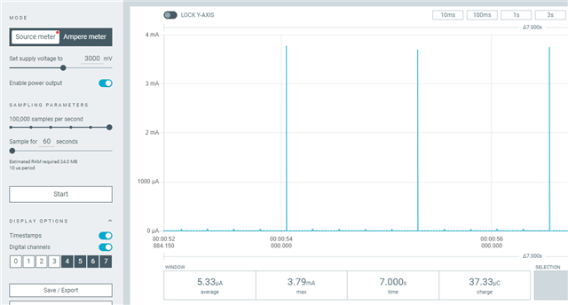

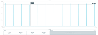

Hi everyone,
I experiment with the saadc low power example. I have followed all the settings but I cannot achieve as low power as the example. As you can see from the PPK II capture, during sampling the current is around 3.6mA and this raises the average current to 9.82uA (almost double than the example). Any suggestion why the current consumption during sampling is so high?
This is my main.c. The only changes I did was to enable the Burst mode and set the oversample to 4x (both settings suggested by the example)
Also, I have disabled the RTT and UART backends.
