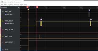

Using SDK15.3 on 52840.  I've got a UART set up talking to something at 9600 baud..
The short course here is that imediately after init, I get an IRQ with a NRF_SERIAL_EVENT_DRV_ERR.  I can send things on the UART but it's not seeing things coming in.
Setup of the UART is:

Right after this I get an IRQ with that NRF_SERIAL_EVENT_DRV_ERR.  After this I can send out (correctly) stuff on the TX pin (correct baud rates and everything) but it's completely missing anything on the that is coming back in.  I get no IRQs on it at all.
Any hints at what to look for here?
