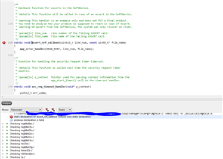

"static declaration of 'assert_nrf_callback' follows non-static declaration"
I don't think I have to touch the code, even if, yeah, I see that one is declared as static and not the one, but it works perfectly well on IAR, and both files are SOUP, that seems to work without problem with each other. Also I am a beginner, not knowing perfectly well the consequences of just delete the "static" before the problematic declaration

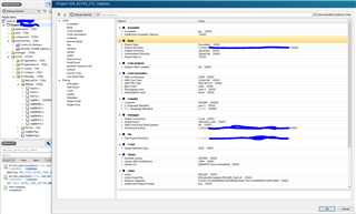

Some config point :
The error :

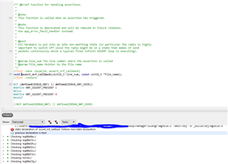

The previous declaration :
