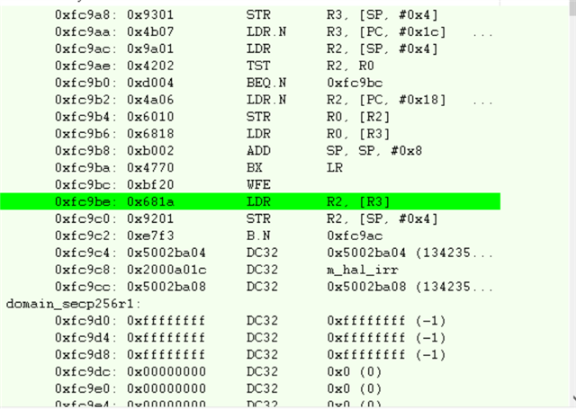

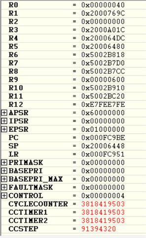

    Could you please take a screenshot of the CPU registers and dissambly view when the program is stuck? Also, are you calling this function directly, or via the nrf_crypto_hash_update() function like how we do it in nrf_dfu_validation.c?
    Vidar
    find the below screen shots.
    Regards

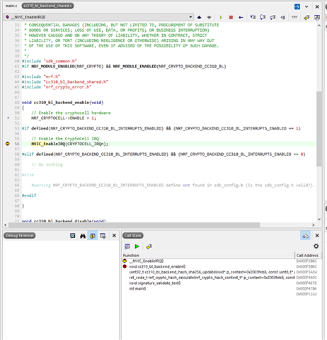

    Which variant of the cc310 are you including in your project? And have you verified that the Cryptocell interrupt actually gets enabled at the line shown in the screenshot below?
  • Hi Vidar,
    I checked the Cryptocell interrupt is enabled in my case also. Its the same thing what you mentioned in the screen shot.
    So the catch here is in my nrf52840 board right two bootloaders are flashed. First one is the open bootloader and second one is the secure bootloader code.
    and the flow is like ----MBR---->SOFTDEVICE---->OPEN_BOOTLOADER--->SECURE_BOOTLOADER--->APPPLICATION
    Case 1: - if both bootloader is present then hash calculation getting stuck in secure_bootloader code.
    But
    Case 2:- If only secure bootloader is present then it works fine no issue in hash calculation.
    i tried with your example code also and its working fine in 2nd case. but 1st case same issue even with your example code also. in bootloader 1 i am verifying the hash and signature and then jump to the bootloader 2. so could it be the jumping part that can cause this issue...?
    This thing only i am not able to figure out. with 2 bootloader only issue comes. i mentioned the address below.
