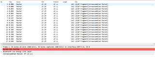

No peripheral connection after disconnect with Android App Nordic Uart Service until mac-address of smartphone changes
No connection after disconnect with Android App Nordic Uart Service until mac-address of smartphone changes
Multilink multirole software developed in SES studio.
Other smartphone can connect without reset of NRF52 or I should wait until first phone changes its mac-address.
No feedback (from any handle) from NRF52... just no connection

  • Hi
    The "6320.wireshark.pcapng" file only shows L2CAP fragments from the Master (central side) on my end
    Regarding the disconnect reason (19) you're seeing, this can be a few things. The one I think is most likely, since you're only seeing this issue with one specific phone. Is that the phone is struggling with keeping up with the crystal frequency on the nRF52833 DK at low connection intervals, causing it to disconnect even though it has been able to connect once. You can try increasing the MIN_CONN_INTERVAL and MAX_CONN_INTERVAL to larger values to see if that helps. For example to 50 and 100 respectively.
    Simon
  • Dear.
    disconnect 19 is not a problem. I disconnect it manually.
    But I cant connect again til mac address android changes (different android)
    No any feedback from nrf52.
  • Okay, sorry about the misunderstanding. In the raw sniffer log you have uploaded there only seem to be connect indications with no response from the phone. What have you set the CONN_INTERVAL values to in your central, if it's too short, the phone might not have time to respond to the CONN_IND if this is too low.
    Simon
