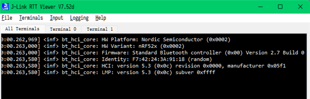

i've two 52840DK, ncs1.8.0, windows10 X64.
D:\Program\v1.8.0\zephyr\samples\bluetooth\periodic_adv\
D:\Program\v1.8.0\zephyr\samples\bluetooth\periodic_sync\
I didn't change any source code and configure, but commented a line of printk("[DEVICE]:,
i got error like this:
[1;31m<err> bt_scan: Unknown handle 0x0000for periodic adv sync lost[0m
thanks a lot

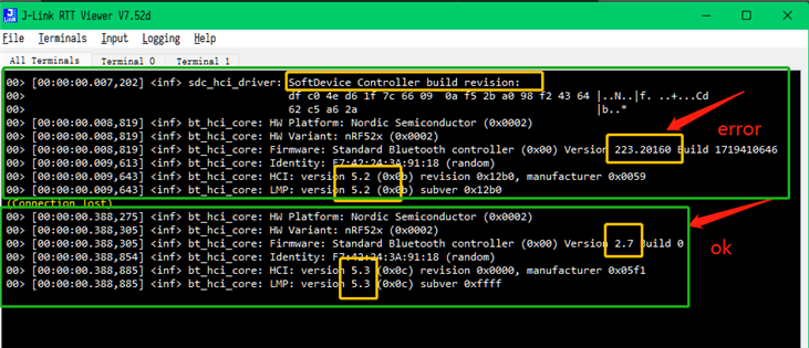

  • Coming back to both v1.8.0. The periodic_sync code waits for 10s for a message from the perodic_adv code.  The problem might be on the periodic_adv config response. However, there are also issues how the periodic_sync handles this situation. A bit more on the logs:
    Waiting for periodic sync...
    [00:00:26.658,660] <err> bt_scan: Unknown handle 0x0000for periodic adv sync lost
    failed (err -11)
    Deleting Periodic Advertising Sync...[00:00:35.461,517] <wrn> bt_hci_core: opcode 0x2045 status 0x0c
    failed (err -5)
    We are aware that the periodic_sync sample is not stable, and that it could hardfault. Support for Periodic Advertising is experimental in NCS v1.8.0.
    Thanks for reporting this. We are working on a fix.

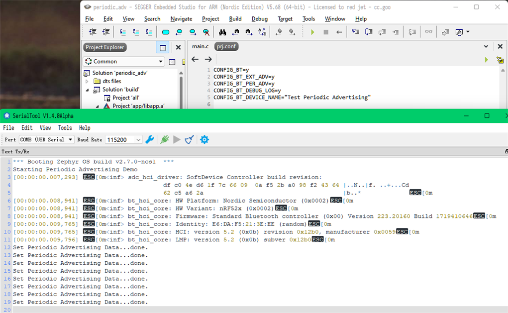

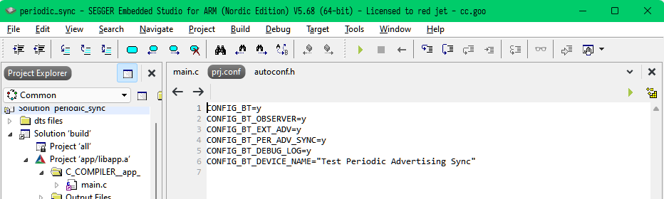

  • Hello,i've fix it,
    prj.conf  set    CONFIG_BT_LL_SW_SPLIT=y
    Two methods fix it:
    First  cmd build
    west build -b nrf52840dk_nrf52840
    west flash --erase
    second  reinstall SES
