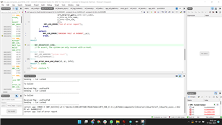

Libuarte+app template ERROR 0 [NRF_SUCCESS]
I have added libuarte example in-app template and sent data from Arduino to nRF52840 successfully. But after receiving some data and I am getting the following error. Any solution please?

  • Hello Muqarrab,
    I assume this example should work by default. However it does seem like you have made some serious changes to it? You removed the nrf_libuarte_async_tx call from the RX event for instance? I dont see the reasoning behind that.
    At the heart of the issue, you are trying to free more bytes than you have actually received somewhere. But with potential modifications made in several places its hard to know where the issue stems from.
    What version of the nRF5SDK are you using? And could you try to make this work with less modifications done to the original, in order to locate the error?

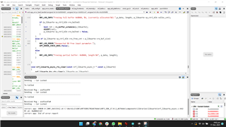

    I have not made so many changes but just merge two codes. if you asked I upload the complete code.
    nRF5_SDK_17.0.2_d674dde.
    code work but after receiving some data it shows the following error.
    The issue is related to RX buffer. can you guide how can I handle that?

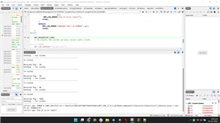

  • Hey Muqarrab!
    I guess it is understandable that you dont want the TX event, as the echo part of the example isn't what you are after. But the buffer is being freed in the case for TX, so you would have to move a couple lines around. As I mentioned earlier, the buffer not being freed in the right spots is what is causing your error.
    I would suggest that you try to remove the echo-like TX lines, save the data from the buffer in an array or whatever you want, and then free the buffer. All in the RX event.

  • Hello Muqarrab, sorry about the delay.
    That looks promising. I think you can remove the loopback phase variable as well, and move the nrf_libuarte_async_rx_free call to the end of the RX event.
