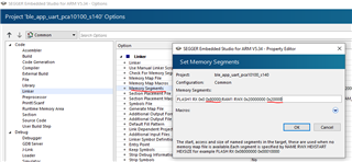

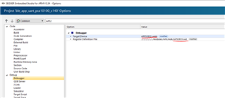

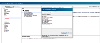

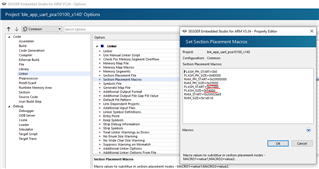

    Sorry for the change, I had to switch peripheral device into nRF52833-DK but I couldn't find ble_app_hrs example for the device.
    Are there other example recommendation for  bonding and pairing with nRF52840-DK central and nRF52833-DK peripheral?
    Thank you in advance.
    PS I tried copy pasting ble_app_hrs example from nRF52840 S140 to other nRF52833 example. I could build it but couldn't run it (got hard fault error). hids keyboard and mouse seems great but I couldn't find good central example to connect it.
    Yes. The RAM start and size depends on your BLE setup (number of services/characteristics, number of connections, MTU size, etc.) so you may need to change this in the future as well. Just monitor the log to see what it should be set to.
