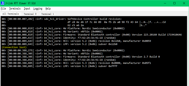

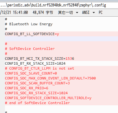

  • Hello Edvin,
    i've found the root cause.
    SES Open nRF Connect SDK Project will created build_nrf52840dk_nrf52840 folder,
    CONFIG_BT_LL_SW_SPLIT=y work well.
    use cmd  "west build -b nrf52840dk_nrf52840 –p && west flash --erase"  will created build folder,
    CONFIG_BT_LL_SW_SPLIT=y  invalid.
    and The two folders are very different;
    because periodic_adv\build_nrf52840dk_nrf52840\zephyr\.config  "CONFIG_BT_LL_SOFTDEVICE=y" and others.
    as follow, first is SES log,next is outlog by cmd build.
    CMD compilation solves many problems, but I don't know why the results of SES compilation are incorrect.
    thanks
