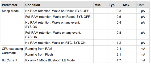

GOAL : I try to measure the current consumption in system off only.
PROBLEM : I measure a current of 8uA in system off while in the datasheet of the PAN1781 et nrf52820 it is sub uA with no ram retention.

  • 1) I tried disconnecting the jumper that power the RF module (PAN1781/nrf52820), I measured 6.5uA ! Which means the devboard consume 6.5uA.
    To sum Up:
    Measure no load = 10nA
    Measure with DK only = 6.5uA
    Measure with DK + RFmodule = 8.3 uA
    Deducing RFmodule=1.8uA .
    2) This is better but not quite what's written on the datasheet.

    https://b2b-api.panasonic.eu/file_stream/pids/fileversion/247007  mentions:
    VDDH (HV mode) Supply Voltage VDDH (optional) min 2.5V max 5.5V
    And I believe that the stated typical currents are only for:
    "Assume VDD = 3 V, Tamb = 25 °C, if nothing else stated, DC/DC enabled"
    According to https://infocenter.nordicsemi.com/pdf/nRF52820_PS_v1.3.pdf page 69
    You can determine the power source from:
    MAINREGSTATUS Address offset: 0x640
    Maybe the high voltage regulator has an Iq of ~1.5uA ?
  • VDDH is shorted to VDD 3.3V. According to the datasheet:
    "The system enters Normal Voltage mode when the supply voltage is connected to both the VDD and VDDH pins (pin VDD shorted to pin VDDH)."
