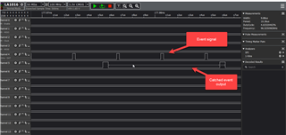

Hello, I tried to use pin_change_example in SDK to catch Interrupts (at first line) but I'm missing lots of them.
How can I catch all the interrupt events without delay?
At present, I am using the ble_app_uart template.
This is the code of GPIOTE init and handler functions

    Is it consistent that you only pick up 1 in 3 events? Or does it vary?
    It is fairly quick. What exactly is it you are trying to do? If you are trying to count pulses, I would recommend that you look into PPI + TIMER in counter mode. Especially if you intend to use the Softdevice, which it looks like you are going to since you started with a ble_app_... example.
    If you don't use PPI, then you may miss a lot of these events, since the softdevice will occupy the CPU from time to time, up to a couple of ms in cases where it has a lot of data to send.
  • Yes, I tried using SPI peripheral
    Yes, I only pick up 1 in 3 events consistently
  • Perhaps there is something else in your application that is running on a higher or same priority that takes up the time in every 3rd event? Try disabling everything but the pin interrupt and see if it picks up more than 1 in 3 events.
