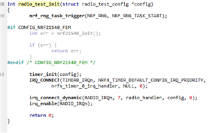

Merge openThread and radio_test code, radio_test test MPSL assert:112,2235
Port the radio_test sample to the Coprocessor sample to test the radio_test function error

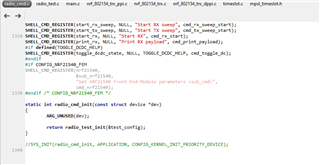

  • Hi
    I now comment out SYS_INIT in radio_cmd.c, that is, radio_test_init is not called  .
    At this point, the shell echo on the emitter side is fine, but the sample code receiver receives the wrong data
    This is one of my puzzles,Timeslot mechanism, I am trying to use it.

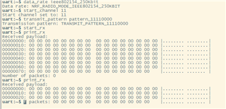

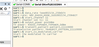

  • Hi
    I don't see what the issue here is. What are you expecting to receive on the RX side here? I think having such a large timeslot might cause issues on the Thread side if there are time critical tasks to take care of, but if it's only to be a thread node for example I think it should be fine.
    Simon
  • Hi
    I want the RX port to always print F0,I configured the enum transmit_pattern pattern = TRANSMIT_PATTERN_11110000 in the radio_tx function.
    Today, I solved this problem with the following code, causing the OpenThread test to fail.Using the Wpantund tool to test OpenThread,  I think this has something to do with timeslot taking up time all the time. Is there any suggestion for modification.
