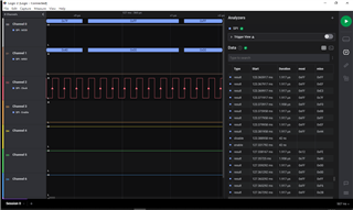

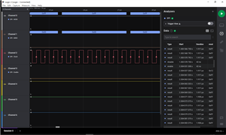

    when I hook the logic analyzer on the SPI lines, I can see the SPI send data to sensor are correct whatever the Bluetooth subsystem is enabled or not. the problem is when the Bluetooth configuration added in prj.conf file, the sensor does not response, the data get always 0.
    the SPI activity when Bluetooth config NOT added:
    the SPI activity when Bluetooth config added:
    for the Bluetooth, the link gave is wrong, the guide I followed is exactly you sugged in last post. for the MTU limitation, I added the  CONFIG_BT_CTLR_DATA_LENGTH_MAX, CONFIG_BT_BUF_ACL_RX_SIZE and CONFIG_BT_BUF_ACL_TX_SIZE. the problem is same.
  • Hi Scott,
    It's strange that the SPI sensor act differently when you enable Bluetooth or not. To avoid any timing issue, I would suggest to delay the initialization of SPI sensor, for example until you press a button. This way it should be exactly the same if you initialize Bluetooth or not. Please also check if VDD is provided to the SPI sensor correctly.
