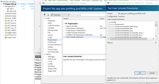

The error is, according to SEGGER Embedded Studio, in my ds_twr_responder.c file pointing to the function call
 APP_UART_FIFO_INIT(&com_params, UART_RX_BUFF_SIZE, UART_TX_BUFF_SIZE, uart_err_handle, APP_IRQ_PRIORITY_LOWEST, err_code);
going to the declaration of the function brigs us to app_uart.h. this file is in de same directory as ds_twr_responder.c along with app_uart.c (in which the function is defined)
I don't really kno where to look as i'm not sure why this error could possibly pop up. Is there some direction i should be looking in?
  • Hi
    It seems you haven't added the necessary header files to this new project you're working on. Adding header files are done by adding the folder path in the user include directories. RIght click the project in SEGGER, select settings, set the build configuration to Common, go to Preprocessor and open User Include DIrectories, and add the folder that app_uart.h is located in to your project. You'll likely have more undefined reference errors like this as well, and you will have to add the folder paths to those header files to your user include directories as well.
