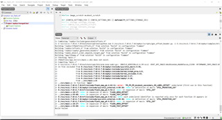

I built soc_flash_nrf fail,I can't find which application that uses this sample,so I can not find what cause this.

This is inherited from this line:

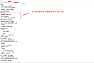

The problem is that when building for multi-image, it does not find the correct second image. If we specify this to be "storage" instead of "image_1_nonsecure", and manually define the storage area in pm_static.yml, it should compile and run properly.
soc_flash_nrf/pm_static.yml should hold this:
storage: address: 0xfa000 size: 0x6000 end_address: 0x100000
Håkon

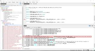

1、
Where is the image_1_nonsecure in this project?I can not find it.
2、I manually define the storage area in pm_static.yml like figure below,then run cmake,but built failed.
Hi
Sorry,Do you mean line 168? I find nothing in this line.

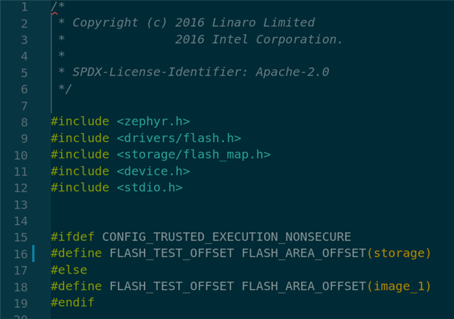

The change is on line 16 in main.c:
Here is the patched project:
Håkon
Thank you,It compiles successfully now.

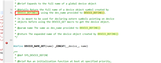

Hi

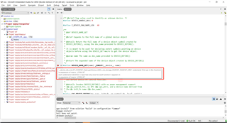

1、It got a error like figure below after I built the nvs which in the v1.7.0\zephyr\samples\subsys\nvs.

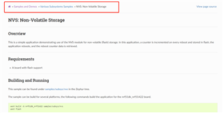

2、I look in the document like figure below,there is not any information about this error.
3、Is the error caused by the DEVICE_DEFINE() ?I do not kown how to use the DEVICE_DEFINE() solve the problem,could you offer me the demo to solve this problem?

This is unfortunately a bug in the sample for ncs v1.7.0. If you upgrade to v1.8.0 (or newer), it should work as expected.
