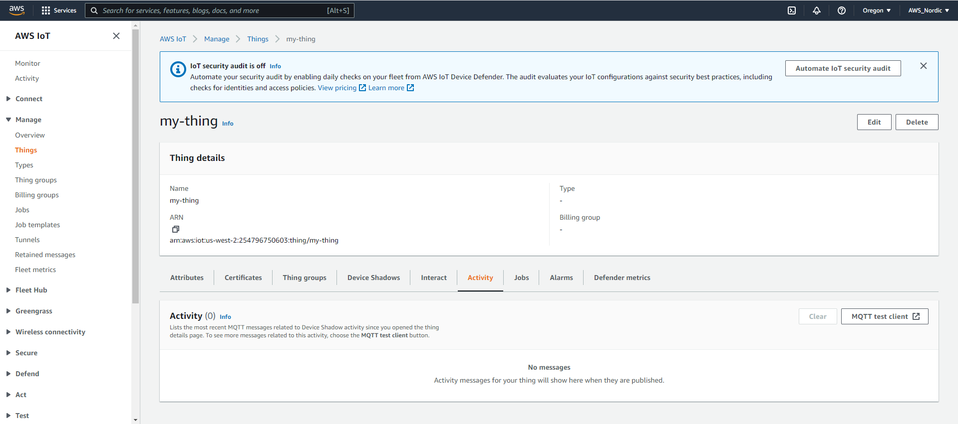

I am trying to connect asset_tracker_v2 to my aws iot cloud with MQTT,
then storing this data in aws database, when i changing parameters to AWS Iot library,
i have a fatal error, i am not understanding why ?
  • I am workin whit nRF9160, thingy:91 and nRF9160_DK
  • I use nRF Connect SDK V1.8.0 whit SEGGER embedded Studio
  • I have an alredy existing AWS account
  • I have downloaded certificate successfully to µc
That is my configuration:
And that is my log output when building and running:

2021-12-26T14:20:41.541Z DEBUG modem << [00:00:00.310,821] [1;31m<err> aws_iot: Application subscription list count mismatch[0m
2021-12-26T14:20:41.544Z DEBUG modem << [00:00:00.318,634] [1;31m<err> aws_iot_integration: cloud_ep_subscriptions_add, error: -122[0m
2021-12-26T14:20:41.549Z DEBUG modem << [00:00:00.327,087] [1;31m<err> aws_iot_integration: populate_app_endpoint_topics, error: -122[0m
2021-12-26T14:20:41.554Z DEBUG modem << [00:00:00.335,754] [1;31m<err> cloud_module: cloud_wrap_init, error: -122[0m
2021-12-26T14:20:41.559Z DEBUG modem << ASSERTION FAIL [err == 0] @ ../src/modules/cloud_module.c:698
