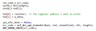

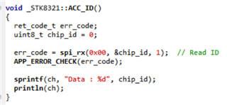

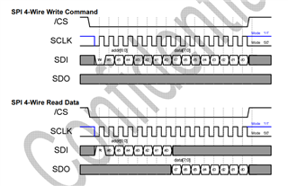

I want to read sensor data through SPI communication, but I don't know how to separate Tx and Rx into nrf_drv_spi_transfer.
Example.

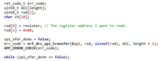

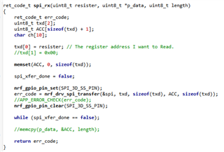

1-1. If I want to read the 0x00 register address, is it right to set it up like below?
1-2. When I read the 0x00 register address, do I have to read the register address + 0x00?
2-1. Is this the right way to use data through SPI?
