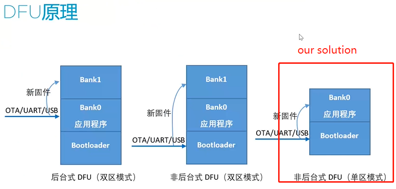

We plan to use nRF52840 in our new project. But the application is likely to be larger than 500 Kbytes
So we are going to use the only one Bank flash for DFU as in following screen shot .
This means that we need to do UART DFU in mcuboot bootloader. We need to fetch new image from a Modem module by UART and write the new image into application flash area.
