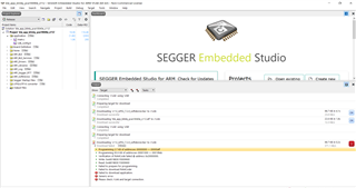

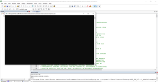

    I'm going to show you my harware and show you what happen when i try to load the project. (build is okay)

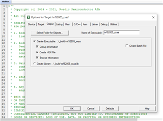

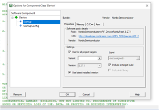

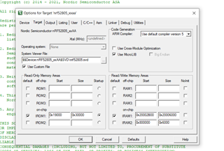

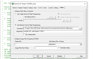

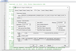

      the command tab is open but stay open and nothing happen. I'm going to give you the parameters that  i put in keil options.
    Thanks again for your help
