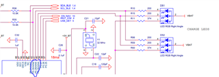

  • hmolesworth,

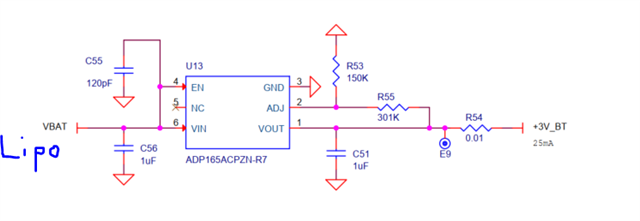

    In response to your comment about the LED.  Here is that section of the schematic.  I'm not sure the LED staying on after a reset is the problem.  The LED are connected to GPIO and then programmed for funcationality in our program.  So, with an empty memory, I think the datasheet shows these are reset as input pins.  My guess is that this causes the LED to be HIGH when the board is bricked, and even while the P0.21 pin reset is toggled.
    The fact that even after the erase command, where the system clears the settings of the reset (I think) and does a system reset to 'enact' the new UICR values, even after this I still need the 3V external in order for the chip connect.  That is suspicious.  As a side note, after this erase, the LEDs are all off so long as the 3V external is applied.  When I take off the external, the LEDS go back on and the board cannot connect to nrfjprog.

  • LED on during reset pin low implies no internal VCC available even if voltage is on the VCC pin so instead internal VCC is coming from the LED pin through the schottky protection diode to internal VCC and thus illuminating the LED; if the chip were in reset the LED port pin would not be driven low at all and would not be lit. This implies the internal LDO (or DCDC if that is hat you are using) may be bust. Try enabling the internal DCDC at powerup  then remove the 3 volts on the reset pin and see if the it still dies.
    Otherwise we are quite sure there isn't a simple code bug? Check by while(1); at power up, no other code run at all; no offense intended.
    Edit: Just to clarify (couldn't edit my last post, still issues with this forum in editing) the thesis is that the Reset pin has become the new source of VCC for the nRF52, nothing to do with reset functionality. Any other i/o pin might also supply VCC if it were directly connected to 3 volts, then maybe the reset pin (now not connected to 3 volts) would work also as expected. Worth a try .. if this the case the current into the Reset or other io pin will be (say) 4 or 5mA since it is supplying the entire internal VCC. How could this have happened? Well ..
