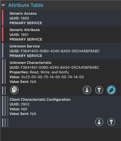

    After playing around, I realized taking the traditional approach that uses notification_enabled flag may not work since my Send() function doesn't really take in conn_handle for instance, and blcm_link_ctx_get() returned with an error of 14.
    So I tried just getting rid of APP_ERROR_CHECK() from my Send() function to avoid assertions, however now I just don't seem to be getting any event  (ble_cus_on_ble_evt isn't firing) upon pressing the Enable Notification button on the nRF Connect app,
    And its Value field remains N/A

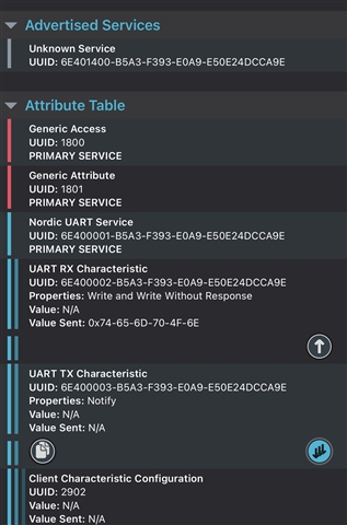

    Actually, for some weird reason, it seems to be picking up NUS as opposed to my custom service. This seems odd. Do you see what may be happening? I tried reinstalling the app to noa vail
