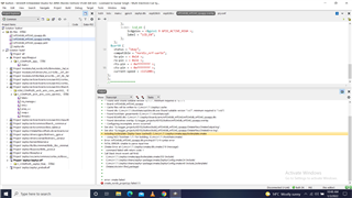

uart overlay CMake syntax error
I added the uart overlay as shown in attached file. When, Run CMake is executed, the error is shown as in attached image.
7608.nrf5340dk_nrf5340_cpuapp.overlay

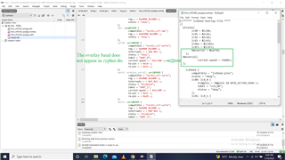

    The modified overlay 3554.nrf5340dk_nrf5340_cpuapp.overlay look like this:
    //****** lcd16x2 Overlay File ****
      aliases{
            lcd0 = &lcd0;
            lcd1 = &lcd1;
            lcd2 = &lcd2;
            lcd3 = &lcd3;
            lcden = &lcden;
            lcdrs = &lcdrs;
            bmsserial = &uart0;
        lcd16x2 {
            compatible = "lcd16x2-pins";
            status = "okay";
            lcd0: lcd_0 {
                lcdgpios = <&gpio1 10 GPIO_ACTIVE_HIGH >;
                label = "LCD_D0";
                status = "okay";
            lcd1: lcd_1 {
                lcdgpios = <&gpio1 11 GPIO_ACTIVE_HIGH >;
                label = "LCD_D1";
                status = "okay";
            lcd2: lcd_2 {
                lcdgpios = <&gpio1 12 GPIO_ACTIVE_HIGH >;
                label = "LCD_D2";
                status = "okay";
            lcd3: lcd_3 {
                lcdgpios = <&gpio1 13 GPIO_ACTIVE_HIGH >;
                label = "LCD_D3";
                status = "okay";
            lcdrs: lcd_rs {
                lcdgpios = <&gpio1 14 GPIO_ACTIVE_HIGH >;
                label = "LCD_RS";
                status = "okay";
            lcden: lcd_en {
                lcdgpios = <&gpio1 15 GPIO_ACTIVE_HIGH >;
                label = "LCD_EN";
                status = "okay";
        lcd16x2 {
            compatible = "lcd_pins";
            lcd0: lcd_0 {
                lcdgpios = <&arduino_header 10 GPIO_ACTIVE_HIGH>;
                label = "LCD_D0";
            lcd1: lcd_1 {
                lcdgpios= <&arduino_header 11 GPIO_ACTIVE_HIGH>;
                label = "LCD_D1";
            lcd2: lcd_2 {
                lcdgpios = <&arduino_header 12 GPIO_ACTIVE_HIGH>;
                label = "LCD_D2";
            lcd3: lcd_3 {
                lcdgpios = <&arduino_header 13 GPIO_ACTIVE_HIGH>;
                label = "LCD_D3";
            lcdrs: lcd_rs {
                lcdgpios = <&arduino_header 14 GPIO_ACTIVE_HIGH>;
                label = "LCD_RS";
            lcden: lcd_en {
                lcdgpios = <&arduino_header 15 GPIO_ACTIVE_HIGH>;
                label = "LCD_EN";
    &uart0{
        current-speed = <9600>;
    The UART_0 in the zephyr.dts will be updated like this:
    			uart0: uart@8000 {
    				reg = < 0x8000 0x1000 >;
    				interrupts = < 0x8 0x1 >;
    				status = "okay";
    				label = "UART_0";
    				current-speed = < 0x2580 >;
    				tx-pin = < 0x14 >;
    				rx-pin = < 0x16 >;
    				rts-pin = < 0x13 >;
    				cts-pin = < 0x15 >;
    -Amanda
