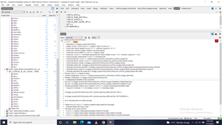

  • Dear, I tried to add the  WIFI=y  and ETWORKING=y in Proj.conf file. But, when CMake is started, the errors are there as shwon in attached image.
  • Hi Gulzar,
    Please have a look at the wifi sample found in zephyr/samples/net/wifi. This sample is mentioned in the documentation of the shield.
    Regarding WIFI=y and NETWORKING=y, this should have been CONFIG_WIFI=y and CONFIG_NETWORKING=y. These configs are already included in the already mentioned wifi sample.
