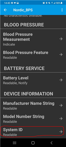

Hi All,
SDK => v17.1.0
IDE => Segger
Project => ble_app_bps
I use LightBlue to connect my board,and going down to the device information service I choose system ID like this.

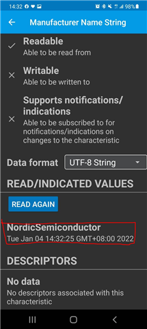

And I will click read again that can show me like this.
My question is : How does Nordic pass the information to the phone?

  • Hi Kai,
    The data is stored in the softdevice when you declare the characteristic.
    If you want to update the data you call sd_ble_gatts_value_set() or you can call sd_ble_gatts_hvx() to not only update the characteristic value but also send a notification/indication to the phone.
    Please study the example provided in the SDK.
