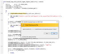

where otIp6IsAddressUnspecified is located
got like this
    You can reference the CLI source implementation in OpenThread, and use the same functions in your application to add/remove/detect IP addresses.
    The sources are located in the OpenThread GitHub directory, e.g.: https://github.com/openthread/openthread/blob/c6a258e3a5bd90aa26d8245c435c0ae5797027f4/src/core/api/ip6_api.cpp. The SDK is delivered with pre-build libraries of OpenThread, without source files. You can clone and build the libraries on your local PC for the debugger to find the correct paths to the source files.
