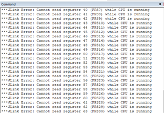

i used tool to write the s140_nrf52_6.1.0_softdevice.hex and nrf52840_xxaa.hex(from example ) to NRF52832 by nrf connect  as above
then i reset the board, but i can not scan the ble advertsing by the nrf connect on the phone. I think the chip is not working

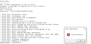

then i use keil to debug the board、
it is working and start to advertisiing、
but the keil IDE give information as follow when i can use nrf connect on phone to connect the board。
and  i found the ble connection is still working。 i can connect/disconnect the ble,  and send data to the ble
and when i shut down the debug, the connection is also  shuted down
i have no idea what cause this case
i suppose may be that the reset function is not working
i pictured the information as follow
pls give me some advice

  • Hi again
    How have you connected the third party board to the DK or J-Link device you use to program it and debug the device?
    Since this is the BLE UART app it is also expected to be connected to the PC over UART which I'm guessing this third party module is not, so the ble_app_uart might not be the best application to test on a third party board. I would suggest trying out the ble_app_hrs example. The connection seems to be correct in nRFConnect as it seems to program the board correctly, but there's some issue running the project.

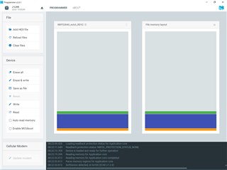

    right now a new problem appeared
    i use the nrf connect to load the follow hex。 ble_app_hrs
     \components\softdevice\s140\hex\s140_nrf52_7.2.0_softdevice.hex
    \examples\ble_peripheral\ble_app_hrs\pca10056\s140\arm5_no_packs\_build\nrf52840_xxaa.hex
    it seem failed。
    and i use keil to debug
    i had a nrf52832 development experience bofore。it worked well and easy to get started
    i guess that  the reason caused this may be the reset  or configure something
    can u give me advise?
