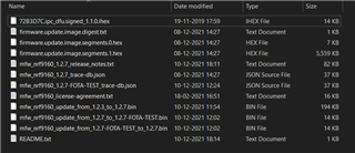

nRF9160 DK full_modem_update FOTA failing with E: Unable to decode wrapper and Error: fmfu_fdev_load failed: -22
I am trying to perform full modem FOTA update on my nRF9160 DK board using sample code without using buttons press functionality as we want to integrate the same code to our own software.
I have performed below configurations before flashing the nRF9160.
1. Set SW10 to nRF52
2. Created device tree overlay file in zephyr\samples\hello_world\set_9160_ext_flash.overlay with the following contents:
&external_flash_pins_routing {
status = "okay";
3. Ran below commands on bash terminal
    west build -b [email protected] -- -DDTC_OVERLAY_FILE=set_9160_ext_flash.overlay
    west flash
4. Set SW10 to nRF91
5. Flashed below code to nRF9160 DK :

Applying full modem firmware update from external flash
Current modem firmware version: mfw_nrf9160_1.2.3
Please help me to figure it out asap. Its blocking our development activity.
Note:
NCS version : 1.6.0
Modem Firmware version: 1.2.3
Device Revision : NRF9160_xxAA_REV2
Board Version : PCA10090
Thank You !
