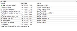

The stack trace when the DFU fails is this -

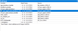

The stack trace when the DFU works (when app_shutdown_handler() returns true the first time through it) is this -
  Am I missing something on how I've implemented this?
