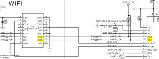

My custom board has nRF52833 mcu and wifi module(esp-wroom-02). I'm going to communicate with these two using the uart port.
The problem is, data communication is not possible with each suitable port.
I checked the waveform of each pin using an oscilloscope.
There is no waveform on the TX pin of mcu (i.e., RX pin in the wifi module), and it seems to communicate only with mcu's RX pin. (Only in the TX pin of the wifi module)
I'm not sure, but each of the tx and rx pins seems to be connected well on hardware. and also I set the port correctly and set it correctly.
Is there anything I didn't check yet?
<this is my customboard schematic>
RX2 (G1) is P(0, 26)
TX2 (H2) is P(0, 27)

Because tx and rx can communicate on one port, they cannot receive the correct data due to conflicts. So it doesn't even interrupt with the uart handler.
It just keeps repeating tx and rx communication on one port.

    If you try to connect the UART pins to a UART terminal, do you see any data there? What do you expect to see on the nRFs TX pin?
    I didn't check UART terminal yet, but I want to communicate with wifi module over at commands.
    // wfcr[] = 'AT\r\n';
    err_code = app_uart_put(wfcr[wifi_tx_idx]);
    so I send basic command ( 'AT' data ) for test using 'app_uart_put'. (I followed 'ble_app_uart' example.)
    briefly, I want to send the at command, but it seems to be confirmed on the RX pin, not the TX pin. If it's not a hardware error, I want to know what kind of error it is.
