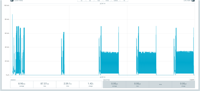

i am trying to use Release Assistance Indication (RAI) to shorten the RRC-Connected using nRF9160 DK.
I'm enabling REL14FEAT with the following AT commands before LTE-connection:
   AT%REL14FEAT=0,1,0,0,0
I then created a socket and configured with the option:
err = setsockopt(sock, SOL_SOCKET, SO_RAI_NO_DATA , NULL, 0);
In my prj.conf file i set:
CONFIG_LTE_RAI_REQ_VALUE="3"
Here is how the current draw looks like:

Is that which i have done realistic? What are the factors to consider when using RAI?

    When using CONFIG_LTE_RAI_REQ_VALUE="3" the lte_lc library will set AT%XRAI=3. That will inform the network that after every packet, we expect one response, and then we want to be released. This is what happens in your trace.After sending a packet and getting a response, the RRC connection is released, and when you want to send a new packet, it is reestablished. In the end, you end up using more energy than if you had just left it open the whole time.
    I also don|t know if the rel 14 feature AS RAI works in NB-IoT, but you need to sned AT%RAI to enable it first anyway. Also note that AS RAI (%RAI) and CP RAI (%XRAI) should not be mixed.
    In the end, RAI is very hard to use correctly, especially with protocols with retransmissions (which DTLS might have). And, when used incorrectly can cause increased latency and power consumption.
