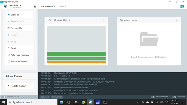

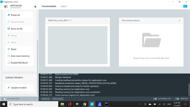

But since the 1st January, when I connected to DK, without any host board connected vis Debug Out pins, I got this in nRF Programmer (serial number of DK, and name with REV1 at the end):
When I connect a host board to DK (SW11=3V, SW5=nRF91), I usually see the host board to select. But now I only see the same serial number of 9160DK, ending with "REV2":

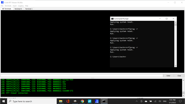

And the RTT Viewer is showing this (no LED lit ON on the host board as it is supposed to be)

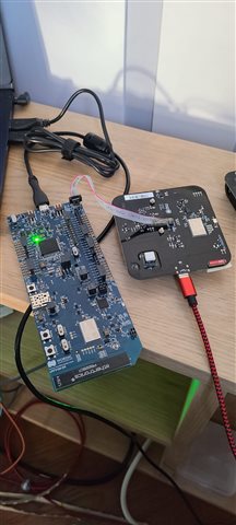

Here is how the host is connected to DK:

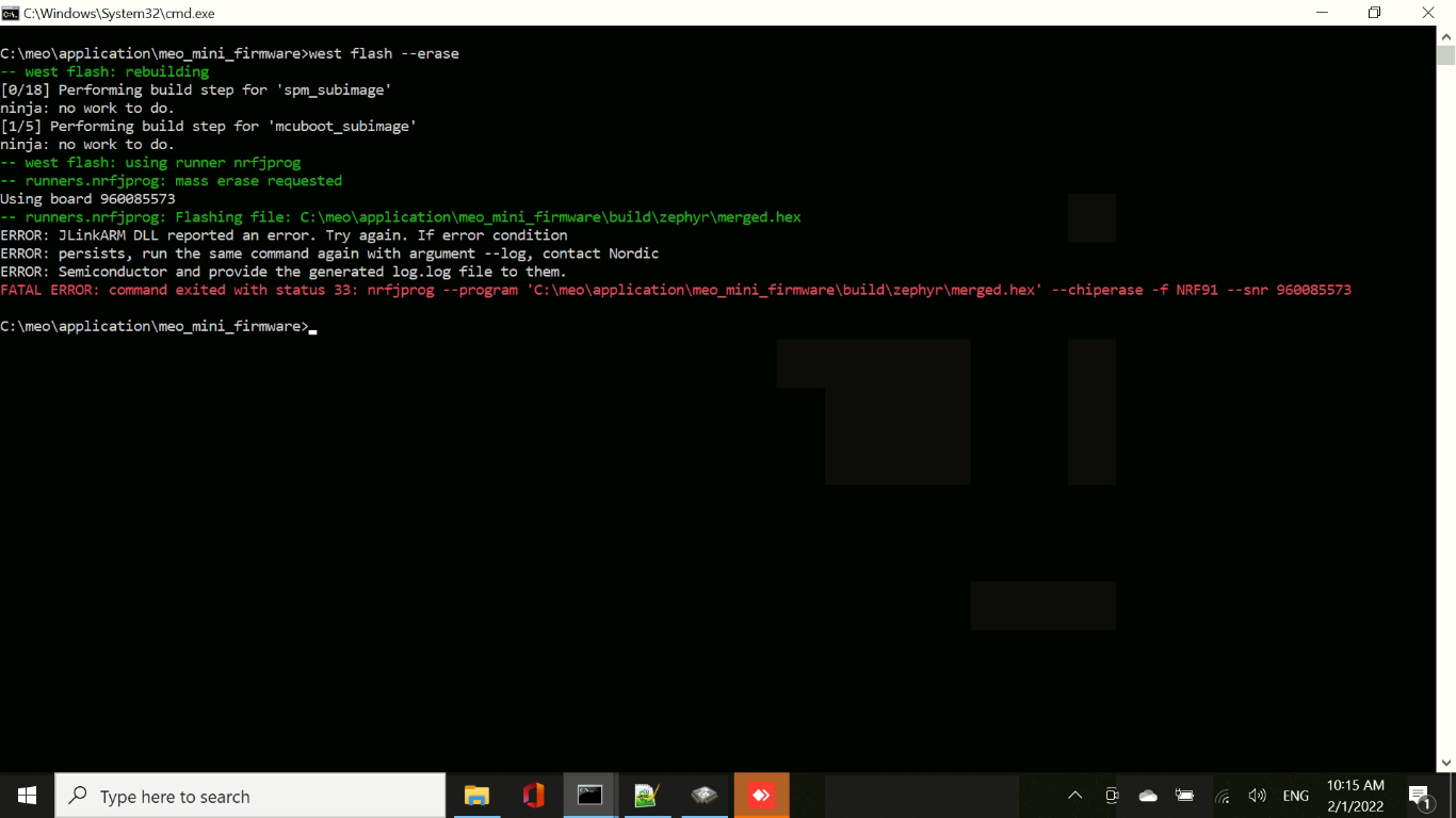

    It seems the issue stands on the mcuboot, that allowed proper functionning until last December, but didn't work anymore since January 2022 when using nRF command line: both nRF Programmer and west flash say host board was flashed but there is no RTT Viewer log on the recently flashed boards. But the previously flashed boards show the logs. And when the host board is updated through fota (with bin file from the cloud, not locally flashed) the host board also show the logs on RTT viewer for the connected board through DK.

    Could you try
    nrfjprog --program C:/meo/application/meo_mini_firmware/build/zephyr/merged.hex --recover -f NRF91
    You should be able to reprogram the device this way.
