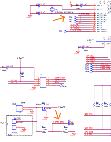

problem: not accurate measurement of battery using ADC
I'm trying to accurately measure our 3.0 volt coin battery (CR2450).
Our product consume low power (<50 uA) and we measure the battery voltage every minute.
We must have an accurate measurement in order to corectly estimate the time left for our product.
the measurements voltage changes over time in 0.01/0.02 volts:
sometimes goes down, somtimes goes up
What I need to do in order to have an accorate measurements
I attached a typical log, circuit drawing and relevant code:

inline uint16_t peripherals_read_vdd(void)
    uint32_t vdd_adc = hal_read_vdd_raw();
    // INFO https://devzone.nordicsemi.com/nordic/nordic-blog/b/blog/posts/measuring-lithium-battery-voltage-with-nrf52
    vdd_adc *= 100 * 6 * 6; // Convert to mV, Gain 1/6, Ref 0.6V
#if VBAT_MEASURE_EXTERNAL_PIN_EN == 1
    // return ROUNDED_DIV(vdd_adc, 4095); // Div by 4095 (12 bits)  and X2
    return (vdd_adc >> 11);
#else
    return (vdd_adc >> 12);
