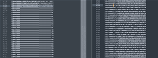

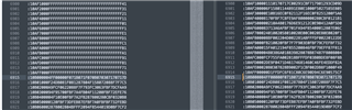

  • Here is a screenshot of hex file comparison of one unit which has been randomly erased and bricked - it boots up enough to turn a led on but nothing else. Maybe it is in a reboot loop and led blinks too fast for me to see, I can check with oscilloscope if necessary.
    To the left we have the faulty unit, it suddenly switches to 0xFFFF for some lines. Right has same hex file flashed to another unit.
    Relevant Intel hex lines are:
    :020000040001F9
    :10A4500092F86530112B03D182F8691082F88E00D2
    :10A46000FFFFFFFFFFFFFFFFFFFFFFFFFFFFFFFFFC
    :10AFF000FFFFFFFFFFFFFFFFFFFFFFFFFFFFFFFF61
    :10B000004FF00000F071B071F070B070307170717D
    So if my understanding is correct, addresses 0x0001A460 .... 0x0001AFFF are erased and 0x0001B000 and onwards  is ok.
    The application uses S132 v6.1.1, so this is in middle of the softdevice as far as I can tell.
    Symptom is different than originally described, but root cause is the same. A portion of flash has gone missing. I can share the full hex files if necessary.

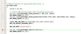

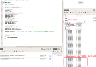

    I verified that ERASEALL operation is blocked when one or more sections are protected with BPROT.
    BPROT protection enabled for Bootloader and MBR regions
    Bootloader main() where BPROT is enabled:
    Can you please verify that these BPROT bits are set by your bootloader as well?

    I still don't understand how the entire flash could have gotten erased. But this particular case would likely have been avoided if the bootloader had correctly enabled write protection for the Softdevice and app in nrf_bootloader_app_start_final().
    This line is currently failing because the size argument is not aligned to a flash page boundary:
        ret_val = nrf_bootloader_flash_protect(0,
                                               nrf_dfu_bank0_start_addr() + s_dfu_settings.bank_0.image_size,
                                               false);
    Fix:
                                               nrf_dfu_bank0_start_addr() + ALIGN_TO_PAGE(s_dfu_settings.bank_0.image_size),
                                               false);
