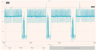

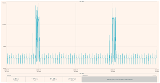

    So I see what's happening here. It took me a moment to understand what the readme actually says, but it describes it correctly.
    By default, the examples (both peripheral and central) is in receiver mode by default, and will continuously scan (drawing ~10-11mA). If you press button 1 on the DK, it will switch to transmitter mode and only advertise. The transmitter will begin toggling a GPIO and all 4 onboard LEDs will light up, and the current consumption will go down drastically (to ~2.7mA) as the device will only be advertising and toggling this one GPIO.
    However I'm not able to see the current consumption going down as you describe initially. It is either around 10-11mA in receiving mode, or ~2mA in advertising mode. It will also stay the same if I connect to the board with my nRFConnect app for Android. Are you sure you put the device to advertising mode and that it doesn't actually try to scan for other timesync peripherals while it is not connected on your end, as it does indeed advertise while in receiver mode as well by default.
    Below are snippets from the Power Profiler application where you can see the two current consumption modes I'm able to replicate with the as-is timesync example project on an nRF52832 DK. You will see some dips in the current consumption in receiving mode, this seems to be because of some timeslots in the application where it sets off some ms to do an advertising event in receiver mode.
    Default receiver mode:
    Advertising mode:
