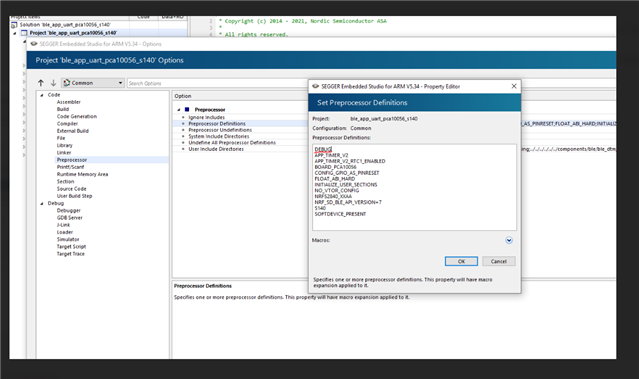

  • Hello Ashish,
    You can add ''Debug'' in your preprocessor definition.
    One thing is you have to uncomment the APP_ERROR_CHECK(err_code) from the code. It needs in the code so that developer can recognize what function does not execute properly.
    For example, if we comment out APP_ERROR_CHECK(err_code) after
    err_code= sd_ble_gap_adv_set_configure(&m_adv_handle, &m_adv_data, &m_adv_params); it will not crash but the advertisement will not be set according to configuration.
    Because we do not know whether NRF_SUCCESS (==0) or some error. then the following line of codes will not work properly.
    if(err_code == NRF_SUCCESS)
    NRF_LOG_INFO("sd_ble_gap_adv_set_configure init successful !");
    }else
    NRF_LOG_INFO("sd_ble_gap_adv_set_configure init failed !");
    You can see the consequence after doing these changes in your application and let us know.
    Hope it helps. Have a nice weekend.

             It worked. Now I am able to tx the raw data over BLE in beacon mode without using the ble_advdata_encode() function.
    Thanks.
