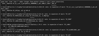

  • Hi Sreejith,
    The battery example is intended to be used with the thingy52, so to be able to use it with another device a  DeviceTree overlay file must be added with the missing configurations.  By copying the missing parts from the thingy52 devicetree into the overlay file you should be able to build it, but there may be other problems:
    	vbatt {
    		compatible = "voltage-divider";
    		io-channels = <&adc 4>;
    		output-ohms = <180000>;
    		full-ohms = <(1500000 + 180000)>;
    &adc {
    	status = "okay";
    I have since my previous comment discovered that our getting started guide with nRF Connect SDK tutorial have a section for setting up and using the ADC. Section 3.5 in part 2 of the tutorial is dedicated to using the ADC, I would recommend that you use this as a starting point instead of the battery example from Zephyr, since it is intended for the nRF5340.
    https://devzone.nordicsemi.com/guides/nrf-connect-sdk-guides/b/getting-started/posts/nrf-connect-sdk-tutorial---part-2-ncs-v1-4-0#h166sjwm56wzcmgvd418wzzus1esk5n3
    Keep in mind that this tutorial have not been updated since version 1.5.0, so there may be some changes needed for it to work with the current version of the nRF Connect SDK.
