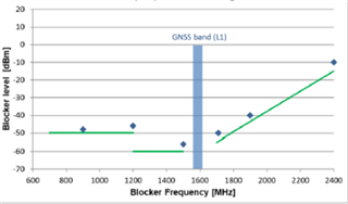

The image below shows how this is specified for a GNSS receiver.  This is a great way to document impact of out of band blockers (when coupled with sensitivity degradation caused by these blocker levels).
